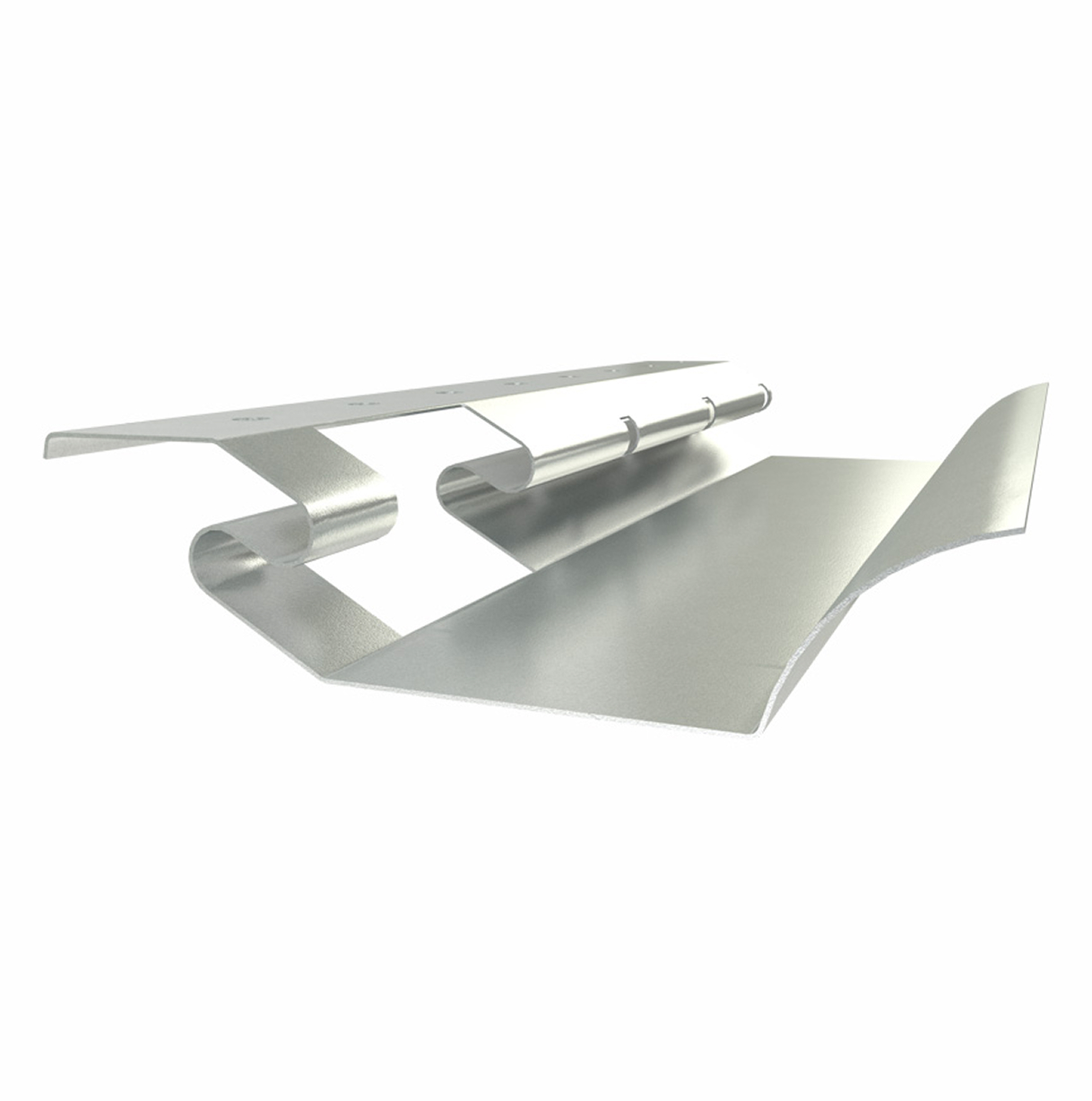

Acoustic profile (AP+) with spring function
AP+ is a uniquely designed suspended ceiling profile from Europrofil with a built-in spring function.
The profile is attached directly to the underlying structure, which must be stable and can consist of concrete, wood, or steel beams, for example. The profile is only 25 mm thick, resulting in a resilient suspended ceiling with minimal construction height. The profile's resilient function reduces both airborne and impact sound.
AP+ is mainly used in directly mounted ceilings, but can also be used for walls. The unique design contributes to improved sound reduction in both wall and ceiling constructions.
Advantages of AP+
- Minimal build height – builds only 25 mm
- Reduces air and step noise thanks to its spring-loaded function
- Used for ceilings but also for walls

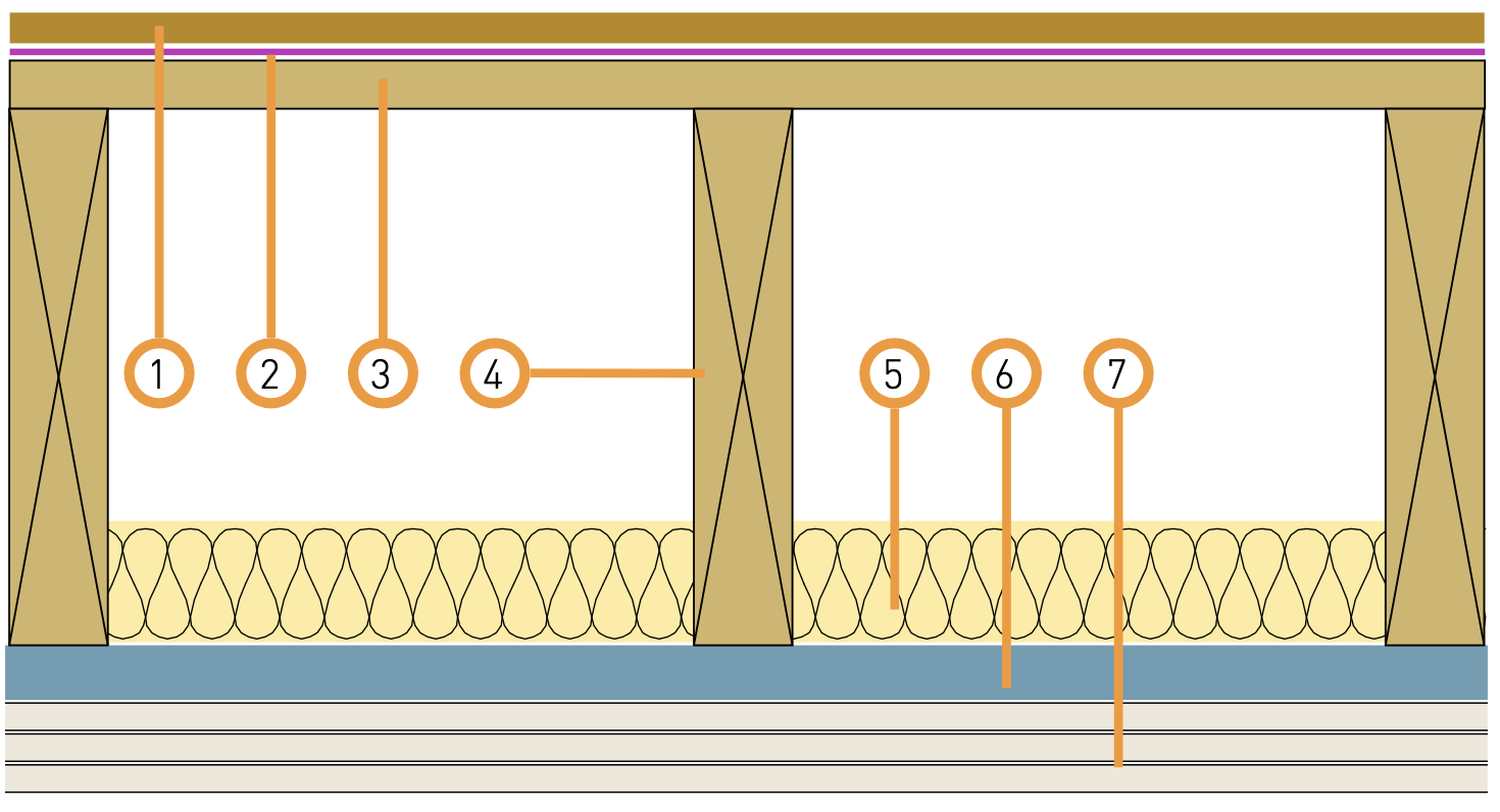

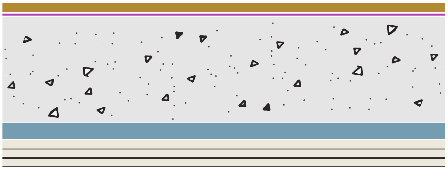

Laboratory measurement of airborne sound reduction and impact sound level with acoustic profile AP+
| Construction | Number of plaster layers | Weighted reduction indexRw | C50-3150 | Weighted step sound levelLn,w | CI, 50-2500 | |
| Wooden floor joists | (db) | (db) | (db) | (db) | ||
![]() | 14 mm parquet* 3 mm foam* 22 Floor chipboard 45×245 Kerto beam, s 600 mm 45 mm mineral wool 25 mm AP+, s 400 mm 2 or 3 layers of plasterboard | 2 x 12.5 mm standard plasterboard 3 x 12.5 mm standard plasterboard | 56 57 | -5 -5 | 58 56 | 5 5 |
![]() | Concrete floor slab 14 mm parquet* 3 mm foam* 160 mm concrete 25 mm AP+ 2 or 3 layers of plasterboard | 2 x 12.5 mm standard plasterboard 3 x 12.5 mm standard plasterboard | 61 62 | -5 -5 | 53 50 | 6 7 |
![]() | Reference floor slab 160 mm concrete, reference measurement | 53 | -3 | 58 | 1 | |
Measurements of airborne sound reduction according to SS-EN ISO 10140-2:2010 evaluated according to SS-EN ISO 717-1:1996 and impact sound level according to SS-EN ISO 10140-3:2010 evaluated according to SS-EN ISO 717-2:
* Only for step sound measurement!
